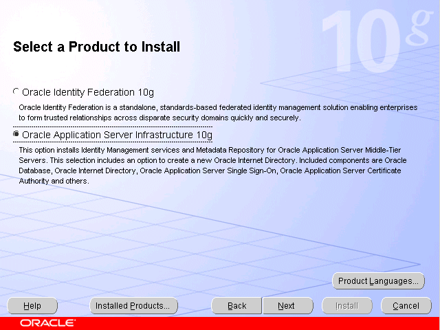

The Select a Product to Install screen appears.
Figure 4-1 Oracle Universal Installer Select a Product to Install Screen
Select OracleAS Infrastructure 10g, as shown in Figure 4-1, and click Next.

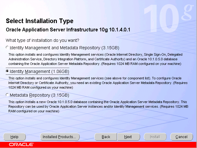

The Select Installation Type screen appears.
Figure 4-2 Oracle Universal Installer Select Installation Type Screen
Select Identity Management, as shown in Figure 4-2, and click Next.

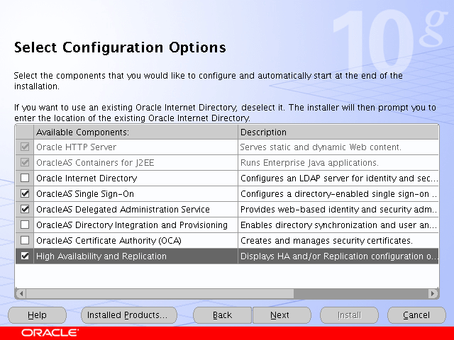

The Select Configuration Options screen appears.
Figure 4-3 Oracle Universal Installer Select Configuration Options Screen
Select OracleAS Single Sign-On, Oracle Delegated Administration Services, and High Availability and Replication, as shown in Figure 4-3.

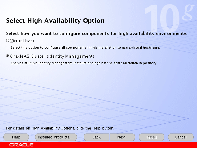

The Select High Availability Option screen appears.
Figure 4-4 Oracle Universal Installer Select High Availability Option Screen
Select OracleAS Cluster (Identity Management), as shown in Figure 4-4, and click Next.

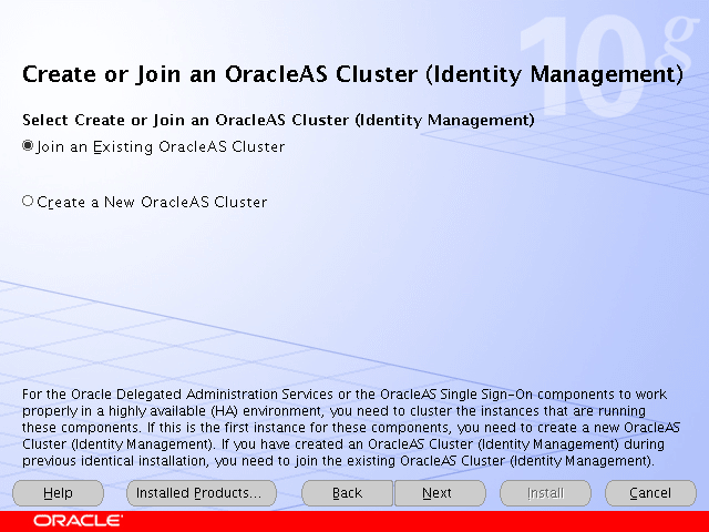

The Create or Join an OracleAS Cluster (Identity Management) screen appears.
Figure 4-5 Oracle Universal Installer Create or Join an OracleAS Cluster (Identity Management) Screen
Select Create a New OracleAS Cluster, as shown in Figure 4-5, and click Next.

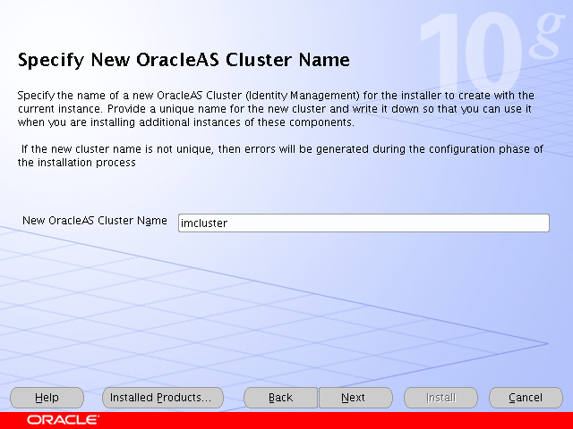

The Specify New OracleAS Cluster Name screen appears.
Figure 4-6 Oracle Universal Installer Specify New OracleAS Cluster Name Screen
Complete the New OracleAS Cluster Name field with a name for the cluster, as shown in Figure 4-6, and click Next.
Note:
Write down the cluster name. You will need to provide it in subsequent installations of instances that will join the cluster.The Specify LDAP Virtual Host and Ports screen appears.

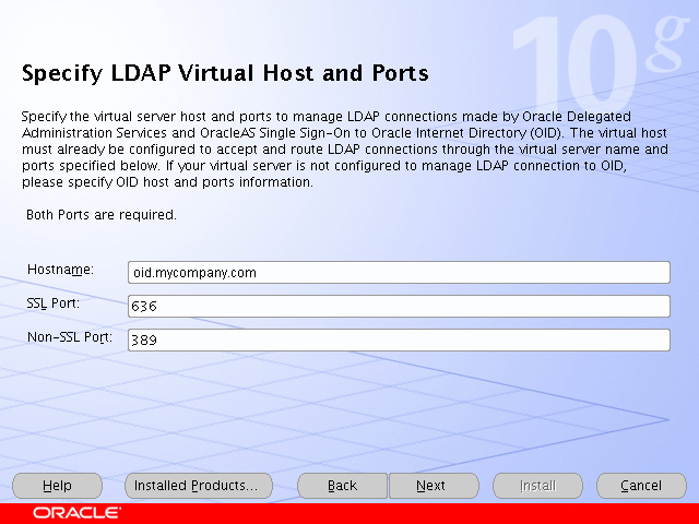

Figure 4-7 Oracle Universal Installer Specify LDAP Virtual Host and Ports Screen
Enter the name of the Load Balancing Router, the SSL port, and the non-SSL port, as shown in Figure 4-7.
Click Next.

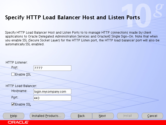

The Specify HTTP Load Balancer and Listen Ports screen appears.
Figure 4-8 Oracle Universal Installer Specify HTTP Load Balancer Host and Listen Ports Screen
Enter the listen port of the HTTP Server and the host name and port of the HTTP Load Balancer, enabling the SSL option for the load balancer, as shown in Figure 4-8.
Click Next.
Figure 4-9 Oracle Universal Installer Select a Product to Install Screen
Select OracleAS Infrastructure 10g, as shown in Figure 4-9, and click Next.
Figure 4-10 Oracle Universal Installer Select Installation Type Screen
Select Identity Management as shown in Figure 4-10, and click Next.
Figure 4-12 Oracle Universal Installer Select High Availability Option Screen
Select OracleAS Cluster (Identity Management), as shown in Figure 4-12, and click Next.
Figure 4-13 Oracle Universal Installer Create or Join an OracleAS Cluster (Identity Management) Screen
Select Join an Existing OracleAS Cluster, as shown in Figure 4-5, and click Next.

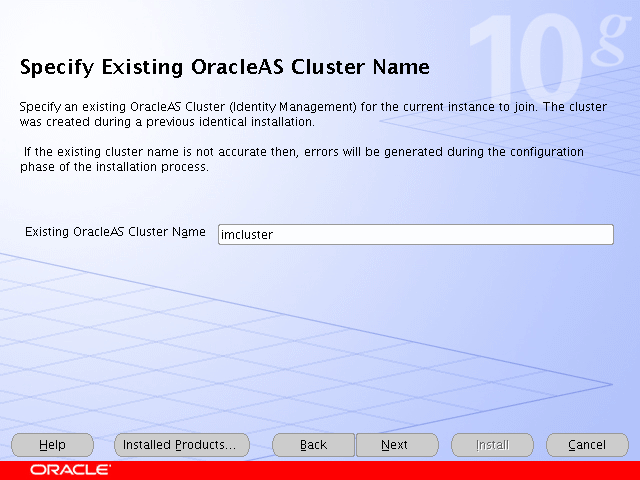

The Specify Existing OracleAS Cluster Name screen appears.
Figure 4-14 Oracle Universal Installer Specify Existing OracleAS Cluster Name Screen
Complete the Existing OracleAS Cluster Name field with the name you provided for the cluster when installing the first instance, as shown in Figure 4-6, and click Next.
Figure 4-16 Oracle Universal Installer Specify HTTP Load Balancer Host and Listen Ports Screen
Enter the listen port of the HTTP Server and the host name and port of the HTTP Load Balancer, enabling the SSL option for the load balancer, as shown in Figure 4-16.
Click Next.
