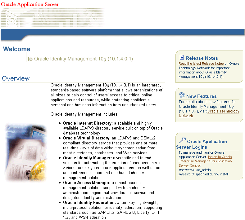

The Oracle Application Server Welcome Page is a great starting point for managing your application server. It includes the following:
Information about the components included in the release
A link to Release Notes
A link to details about New Features in Oracle Application Server 10g (10.1.4.0.1)
A link to the Oracle Enterprise Manager 10g Application Server Control Console—a Web-based tool for managing Oracle Application Server
A link to the Oracle Application Server 10g (10.1.4.0.1) documentation library
Figure 1-1 shows part of the Oracle Application Server Welcome Page.
Figure 1-1 Oracle Application Server Welcome Page
Accessing the Welcome Page
You can locate the URL for accessing the Welcome Page on the End of Installation Screen text, which is in the following file:
(UNIX) ORACLE_HOME/install/setupinfo.txt (Windows) ORACLE_HOME\install\setupinfo.txt
To view the Welcome Page, connect to it using the HTTP listener port on your installation. For example:
http://hostname.domain:port
The default port is 7777.
