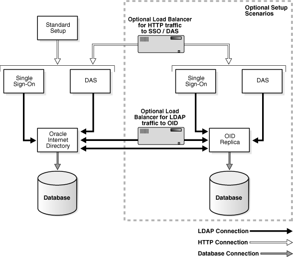

As shown in Figure 14-1, a variety of components and communication paths may be configured for SSL. The following lists references to the instructions for each:

Figure 14-1 Identity Management Components and SSL Connection Paths

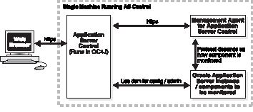

The communication paths of interest in the SSL configuration of Application Server Control Console are shown in Figure 14-2, and are labeled https.
Figure 14-2 SSL Connection Paths in Oracle Enterprise Manager 10g
To secure the communications between the Web browser and the Application Server Control Console, and between the Application Server Control Console and the Management Agent, you can use the emctl secure iasconsole command-line utility. See Section A.4 for instructions.
The communication (that is, obtaining monitoring information and configuration and administration tasks) between the Management Agent and the application server being monitored, and the Application Server Control and the application server being administered is not affected in any way when you use the emctl secure iasconsole utility. Those communication paths are not secured until you perform the application server security configuration steps for the particular path. Instructions on configuring SSL for application server communication paths are provided in Section 14.1 and Section 15.1. In addition to their SSL configuration, some components also require that you perform configuration changes to the application Server Control's Management Agent. The instructions for these changes are included with the instructions for enabling the components for SSL.
