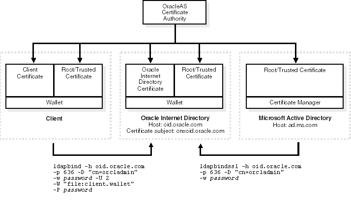

The Oracle Password Filter for Microsoft Active Directory installs a command named ldapbindssl on the domain controller that you can use to test SSL communication between Oracle Internet Directory and Microsoft Active Directory. The syntax for the ldapbindssl is as follows:
ldapbindssl -h oid_hostname -p ssl_port -D account -w password
Figure 20-1 conceptually illustrates how to use the ldapbindssl and ldapbind commands to test SSL communication between Oracle Internet Directory and Microsoft Active Directory.
Figure 20-1 Testing SSL Communication Between Oracle Internet Directory and Microsoft Active Directory
To test SSL connectivity from Microsoft Active Directory to Oracle Internet Directory:
Open a command prompt window on the domain controller and navigate to the folder where you installed the Oracle Password Filter for Microsoft Active Directory.
Enter the ldapbindssl command to test SSL communication with Oracle Internet Directory. For example, the following command attempts to bind to an Oracle Internet Directory host named oraas.mycompany.com on SSL port 636:
ldapbindssl -h oraas.mycompany.com -p 636 -D cn=orcladmin -w welcome1
If the ldapbindssl command is successful, the following response is returned:
bind successful

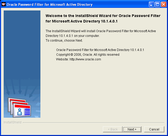

Navigate to the directory where you extracted the installation files and double-click setup.exe. The Welcome page of the Oracle Password Filter for Microsoft Active Directory installation program displays, informing you that the program will install the Oracle Password Filter for Microsoft Active Directory.
On the Welcome page, click Next. The Installation Requirements page displays, notifying you that SSL must be enabled between Oracle Internet Directory and Microsoft Active Directory and that installing the Oracle Password Filter for Microsoft Active Directory must restart your computer at the end of the installation process.

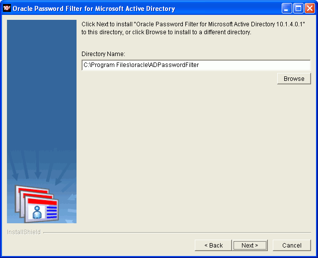

On the Installation Location page, accept the default installation directory or enter a different directory. You can also select Browse to locate a different directory. Click Next after selecting an installation directory. The Microsoft Active Directory Configuration Parameters page displays.

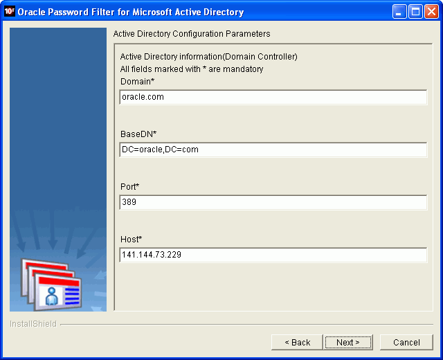

On the Microsoft Active Directory Configuration Parameters page, enter values for the following parameters:
Domain
Base DN
Port
Host
Click Next. The Microsoft Active Directory Domain Controller Information page displays.

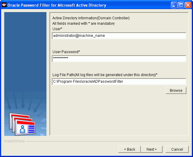

On the Microsoft Active Directory Domain Controller Information page, enter values for the following parameters:
User
User Password
Log File Path

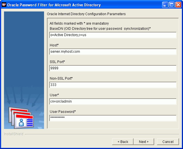

Click Next to continue. The Oracle Internet Directory Configuration Parameters page displays.
On the Oracle Internet Directory Configuration Parameters page, enter values for the following parameters:
Base DN
Host
SSL Port
Non-SSL Port
User
User Password
Important: If you have configured both import and export synchronization between Oracle Internet Directory and Microsoft Active Directory, be sure to enter for the User and User Password parameters the same bind DN and password that are specified in the synchronization profile that imports values from Microsoft Active Directory into Oracle Internet Directory. This is necessary to prevent password updates from looping between Oracle Internet Directory and Microsoft Active Directory. |

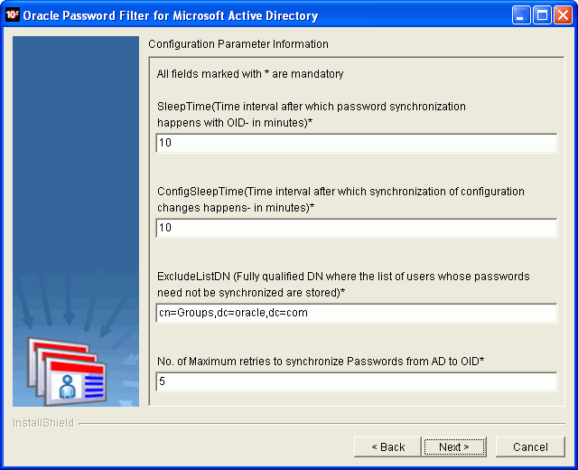

On the Oracle Password Filter Configuration Parameters page, enter values for the following parameters:
SleepTime: The number of minutes between attempts to synchronize passwords changes between Oracle Internet Directory and Microsoft Active Directory.
ConfigSleepTime: The number of minutes between attempts to synchronize configuration changes between Oracle Internet Directory and Microsoft Active Directory.
ExcludeListDN: A fully qualified DN containing a list of users whose passwords should not be synchronized.
Maximum Retries: Specifies the maximum number of attempts to synchronize a password.

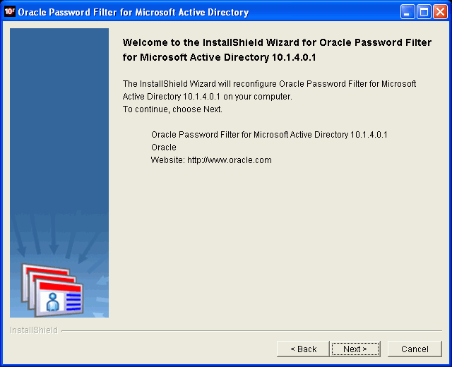

Navigate to the directory where you extracted the installation files and double-click setup.exe. The Welcome page of the Oracle Password Filter for Microsoft Active Directory configuration program displays, informing you that the installation program will reconfigure the Oracle Password Filter for Microsoft Active Directory.

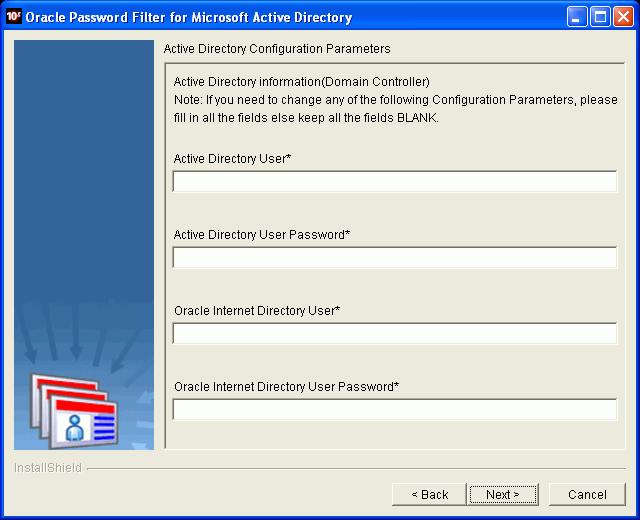

On the Welcome page, click Next. The Microsoft Active Directory Configuration Parameters page displays.
On the Microsoft Active Directory Configuration Parameters page, modify the following parameters:

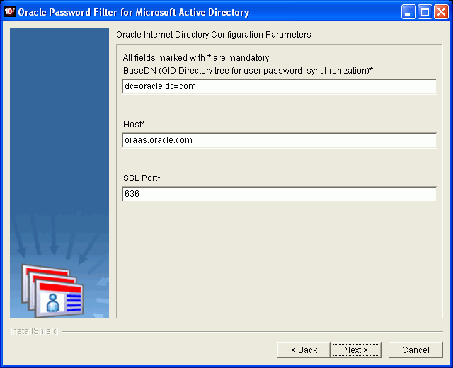

Click Next. The Oracle Internet Directory Configuration Parameters page displays.
On the Oracle Internet Directory Configuration Parameters page, modify the following parameters:
Base DN
Host
SSL Port
Click Next to continue. The Oracle Password Filter Configuration Parameters page displays.
On the Oracle Password Filter Configuration Parameters page, modify the following parameters
Click Next to continue. The Oracle Password Filter Users page displays.
On the Oracle Password Filter Users page, modify the following parameters:
Microsoft Active Directory User
Microsoft Active Directory User Password
Oracle Internet Directory User
Oracle Internet Directory User Password
Click Next to continue. The Reconfiguration Completed Successfully page displays.
On the Reconfiguration Completed Successfully page, click Finish to reconfigure the Oracle Password Filter.
