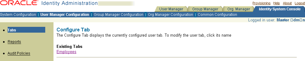

To view or modify tab configuration information
Navigate to the Identity System Console and click User, Group, or Org. Manager Configuration.
The User, Group, or Organization Manager Configuration page appears.
Click Tabs.
The Configure Tab page appears, showing the name of the tab for the application. The Organization Manager may have more than one tab.
Click the link for the tab.

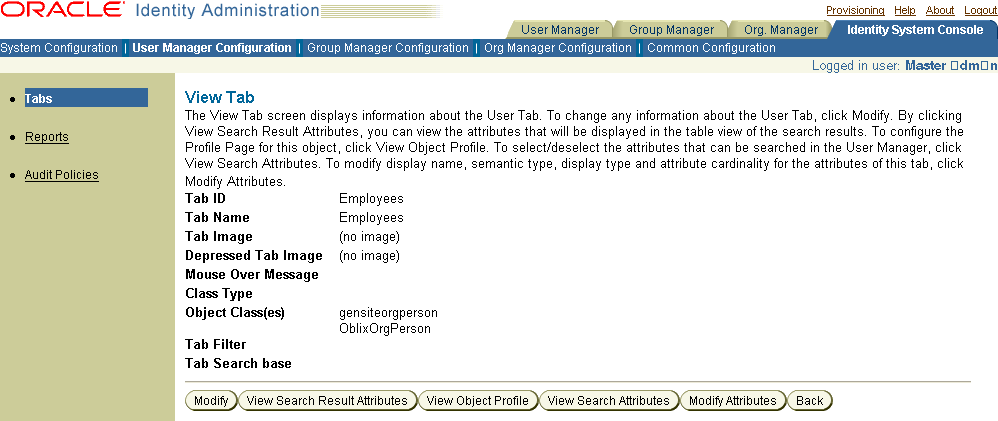

The View Tab page appears.
Table 4-1 describes the information on this page:

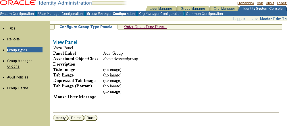

Use Group Types to associate auxiliary object classes with the Group Manager. Oracle Access Manager provides the oblixAdvancedGroup auxiliary object class to enable you to configure attributes for subscribing members to groups, and for creating and expanding dynamic groups.
The following shows page that appears when you click the Group Manager tab and then click the My Group sub-tab. My Groups has been configured with multiple group type panels.
When you create a Group Type panel, the attributes from the associated object class are available in the Group Manager user application.
To add auxiliary and template object classes to the Group Manager
Ensure that you have configured the object class or classes that you want to add in the Common Configuration tab.
See "Adding Object Classes" for details.
From the Identity System Console, select Group Manager Configuration, then click Configure Group Type.
Click Configure Group Type Panels, then click Create.
In the topmost menu, select the object class that you want to add.
In the Panel Label field, enter the label that you want to display to end users when they view elements from this object class in the Group Manager.
Select the Panel Information Is Complete check box.
Click Save.
The object class is added. You can view this new object class by clicking the Tabs link in the left navigation pane for Group Manager Configuration.
To delete auxiliary and template object classes from the Group Manager
Click Configure Group Type Panels.
Click the link for the group type that you want to delete.
Click the Delete button.

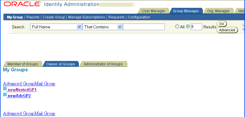

Show groups you are an owner of |
Makes the Owner of Group attribute available on the My Groups page. You must also configure an attribute to be a Group Owner semantic type to use this feature. |
Makes the Administrator of Group attribute available on the My Groups page. You must also configure an attribute to be a Group Administrator semantic type to use this feature. |

From the Identity System Console, click Org. Manager Configuration, the click the Tabs link in the left navigation pane.
Click the link for the tab that you want to delete.
The View Tab page appears. If you have more than one tab defined for Organization Manager, a Delete button appears on this page.
Click Delete.

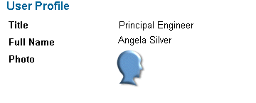

A profile page is a Web page that shows information about an object in an Identity System application. For example, when you search for information about a user in the User Manager, a profile page for that user is displayed. The profile page may contain data such as the user's:
Name
Address
Department
Manager
Phone number
The information on a profile page is based on objects and attributes in the LDAP directory that the Identity System communicates with, or it can be based on information in an object template file.
You can assemble profile pages from a collection of panels. For example, the profile page for a person may contain panels for personal, location, and project information. If you have configured an object template file for provisioning purposes, you may want to place the attributes from the template file on one particular panel.
Users can display profile pages in one of two ways:
A panel view organizes the data on the profile page into panels.
A page view organizes the data on the profile page into one long list.
When you configure LDAP attributes on a panel, the attribute labels and values are shown on the profile pages that use the panel. In contrast, template attributes do not actually appear on the profile page. Template attributes only appear on Modify Profile pages, and then only if you have defined a workflow that uses the attributes.See "Sending Non-LDAP Data to External Applications" for details.
The header panel appears at the top of a profile in the User Manager or Organization Manager. The header displays attributes with the semantic types of Full Name, Title, and Photo from the structural object class for the tab. You can turn the header off so that it is hidden from a user identity profile page.Here is a sample header panel for a user:
Note: You can configure only LDAP attributes from the structural object class for a tab in header panels. |
From the Identity System Console, click User or Org. Manager Configuration, Tabs.
The Configure Tab page appears. The Organization Manager may have multiple tabs.
Click a tab link, then click the View Object Profile button.
Click Header, which is listed across the top of the page.
The Header Panel page displays the attributes that appear in the Profile header. For example, Map Image, Location Name, Location Title.
Click the Modify button, then select each attribute to appear in the header panel.
If you want to display the Header Panel in user profiles, click Show Header Panel in User Manager.
Click Save.

Click the link to the tab.
Click View Object Profile.

Group Type panels allow you to organize attributes on the My Groups tab. For example, if you have configured groupOfUniqueNames as a structural object class and oblixAdvancedGroup as an auxiliary class, you can organize attributes from these classes on the My Groups tab by creating Group Type panels. Note that Group Type panels are reserved for LDAP attributes. You should not configure template attributes on a Group Type panel. Each object class identified as a Group Type (as described in "Object Class Types" in the Identity System can be associated with a Group Type panel.
In the Identity System Console, click Group Manager Configuration, Group Types, then the Configure Group Type Panels link.
The Panels page displays a list of configured Group Type panels.
Click its link to view a Group Type's settings.
The View Panel page appears showing the settings for the selected panel.
You must configure a Group Type panel to organize the attributes for a group object class. At least one panel should be created for the group structural object class. This enables you to view groups that contain only the group structural object class attributes on the My Groups profile page.If you have installed and configured multiple languages, you can localize display names for the following panel fields:
Panel Label
Description
Mouse Over Message
To add, modify, or delete a Group Type panel
From the Identity System Console, click Group Manager Configuration, Group Types.
The Group Types page displays a list of Group Types.
Click Configure Group Type Panels to display the Panels page.
Choose an operation:
To add a Group Type panel, click Create.
To modify an existing panel, click a panel link and from the View Panel page click Modify.
To delete an existing panel, click a panel link and from the View Panel page click Delete.
In the field labeled Select the Group Type, select the object class to associate with the Group Type.
Note: Select only auxiliary object classes that extend the group structural object class or are attached to the group structural object class in the schema. Only configured auxiliary classes can be selected from this page. For more information, see "Adding Object Classes". |
In the remaining fields, enter values as described in "To create or add a panel".
Select the box beside Panel information is complete.
Click Save.

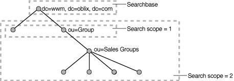

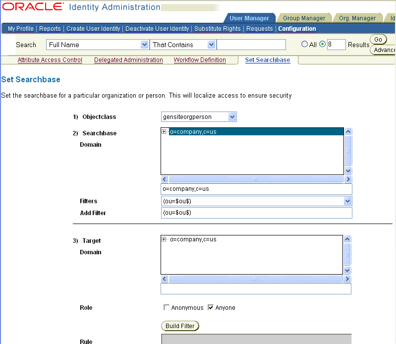

A searchbase is a branch in the directory tree, or it can be the top node of the tree. At installation time, you select the default searchbase. The default searchbase is the node in the directory tree under which all user data is stored and the highest possible base for all user data searches.The searchbase determines the part of the directory tree that is available to a user during a search. You must set a searchbase for each structural object class configured for the Identity System before a user can view its entries. You can set multiple searchbases for each structural object class.When you set a searchbase, you determine who can search what (an object class, at a particular level of the directory tree), optionally using a search filter. Before setting a searchbase you need to determine the following:
What object class (users or groups) do I want to set the searchbase for?
Where will the search begin?
Who can search there?
For example, you can configure one searchbase for employees and another for customers to ensure that customers cannot see employee information.
As another example, if two competing suppliers provide you with parts, you can set the searchbase so that users from each supplier can view only their own portion of the DIT.
Note: You set the searchbase from the User Manager application. This is the end user application rather than the User Manager Configuration function. You also need to configure read permissions for your group profile pages for the group class. |
When you set a searchbase, you have the option to define a filter to identify what branch of a searchbase a logged-in user can view. If your directory tree is particularly flat, so that selecting a node does little to filter the searchbase, the filter feature helps narrow searches. The filter is also useful if your directory tree has a large number of branches, for instance, if you have 10,000 dealerships, you probably want to narrow down searches within the dealerships.However, a filter can affect performance if it yields a large number of entries. Instead of using a searchbase filter, you can set read permissions for the class attribute, as described in "Selecting a Class Attribute". The class attribute is used for attribute access and to link search results to a Profile page.For example, suppose you remove the resource filter from the searchbase, allowing the role of Anyone to access the person object class. Instead of setting the searchbase, you define read permissions for the class attribute, using a rule to specify who can access this attribute. This can reduce the number of directory searches that the Identity System conducts. See "Setting and Modifying LDAP Attribute Permissions" for details.
Note: You can set several searchbases for the same user or group if specific users need to access different parts of the directory tree. For example, if employees need to search both the employee and the customer branches of the tree, you can define searchbases for employees and for customers, and give employees permission to view both. However, be sparing when configuring multiple searchbases for a particular object class. Where possible, define read and write permissions for attributes instead. Multiple searchbases for the same object class can degrade performance. |

The following procedure describes the steps for setting the searchbase.
In the User Manager application, click the Configuration sub-tab.
The Configuration page appears.
Click Set Searchbase.
On some browsers you may receive a prompt asking if you trust the certificate of the application. If this happens, select the Trust Always option.
The Set Searchbase page appears.
In the Object Class list, select an object class.
The object class you select defines what is being searched. For instance, to set a searchbase for widgets, you would select the widget object class. The Searchbase Domain box indicates the top node for the search. The field beneath the Searchbase Domain box is where you enter or edit information.
In the field under the Searchbase Domain box, specify the part of the directory tree where the search for the object may be conducted.
For instance, if you want to define a searchbase for widgets in the Manufacturing Department, you might select the Manufacturing branch of the searchbase.Selecting the top level of the directory tree indicates that the entire domain is available for searches. You can refine the searchbase by selecting a node further down the tree or by entering a filter. For example, to restrict searches to North America, you could select the top node and enter region=North America as the filter. This example assumes there is a branch called North America in your directory tree. See "Usage of Rules and Filters" for details on writing a filter. The Filters box indicates the current filters for the search. You use the Add Filter field, beneath the Filters box, to enter another filter.
Optional: In the Add Filters field, enter another filter.
Click Save.
The new filter appears in a field under the previous filter.Users and groups permitted to search this portion of the directory tree are defined in the next panel.

Make sure there is no value in the Tab Search base field.

Photos appear in the header panel of a user profile. Users with self-service permissions on relevant attributes can manage their own photos.

Another method for storing images and photos for user identities is to store the photos in a location other than the directory. This method is appropriate for GIF and JPEG images, and other image file formats that are supported by your Web server. The Identity Server's WebPass must be able to access this location. You can name the photo or image file using any valid file name that the Web server recognizes and supports. Avoid using special characters such as spaces in the file name. The Web server may not recognize file names that use special characters.
To reference photos that reside in a file system
In the Identity System Console, click Common Configuration, Object Classes.
Click the person object class in the Object Class list.
Click Modify Attributes.
Modify the Photo Path attribute as follows:
Attribute: Photo Path
DisplayName: Photo
Semantic Type: Photo
Data Type: String (case-sensitive)
Attribute Value(s): Single or multi-valued
Display Type: GIF image URL
Assign read and write permissions for this attribute.
Store the images in GIF or JPEG format in the following directory:
WebPass_install_dir/identity/oblix/lan/langTag/style0
where WebPass_install_dir is the directory where WebPass is installed and langTag is the folder that contains the specific language you are using.
Enter the photo location URL in the User Profile Page for each user.
For example, if the image location is:
you set the photo location to:
More than one GIF image can be displayed by setting the photo URL attribute to be multi-valued.

In the Identity System Console, click the Group Manager tab.
In the Search field at the top of the page, enter search criteria.
Click Go. A list of groups appears.
Click the link for the name of the group that you want to view.
In the Group Manager, click My Group.
Conduct a search on groups and click the desired link.
The group profile appears.
Click Manage Group Members.
Select the Member Type you are searching for in this group:
Select People to search for users. Search results can include static, nested, and dynamic users.
Select Groups to search for groups. Search results can include static and dynamic nested groups.
From the Search Members By list, select an attribute as the basis for the search.
Select a search operator.
Enter search criteria.
Click Go.
The Manage Group Members page displays two levels of nested groups and their members in the search results. This includes a child nested group, its members, and its children.
You can delete group members displayed in the search results from the Manage Group Members page. You can only delete static members. You cannot delete dynamic or nested members.
Search for group members from the Manage Group Members page.
From the results that are returned on the search, click the link for the user or group that you want to delete.
Click Save on the Manage Group Members page.

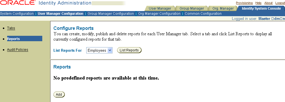

From the Identity System Console, click User Manager Configuration, Reports, then click List Reports.
The following page appears the first time you create a report.
Click Add to display the Query Builder on the Configure Reports page.

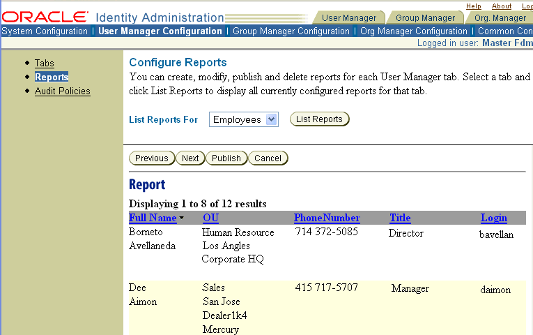

Click Test to verify that the report generates data correctly.
A verification page appears.
Click Save.
A page like the following one appears. Several buttons become available and are highlighted in the following screen shot. These will be used in the next procedure.
Click Next to see additional report results, or click Publish to save the report.

Some portions of the Identity System call out to external XML files to get configuration information. The globalparams.xml file is one such file. This file controls search scope among other things.By default, the search scope is set to subtree for the Identity System, meaning that the search begins at the starting point of the searchbase and includes its children. Depending on the size of your directory, you may want to change the default search scope using the ResourceFilterSearchScope parameter. The possible values for this parameter are:
1: Search the top node of the searchbase and the first level under it.
2: Start at the top node of the searchbase and proceed to the bottom node.
Figure 4-1 shows that setting ResourceFilterSearchScope to 1 could limit results to just a few returned entries, while setting it to 2 could return thousands of entries.

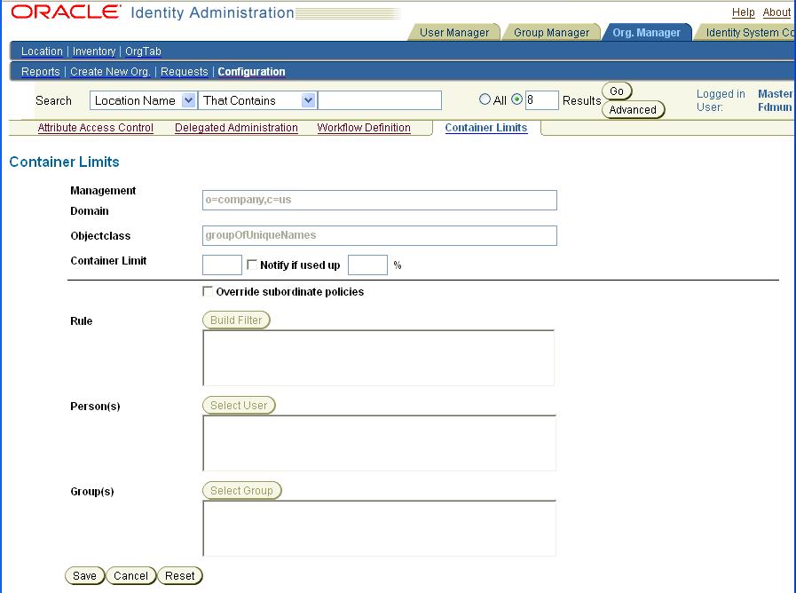

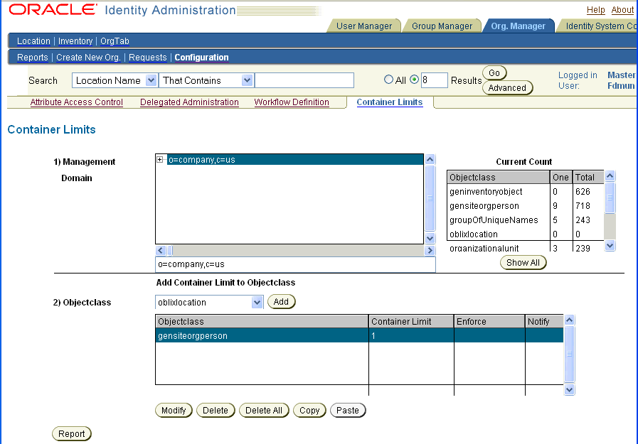

Use the Container Limits function to control the number of objects and child objects for an organizational unit and its object classes. You can define who receives notifications when the limit is about to be exceeded. For example, you can have organizational units in your directory tree that you use for storing extranet customers. You can limit to 10,000 the number of customers with access to your extranet portal.
Note: The Container Limits feature counts the number of objects from the directory. If the number of objects is very large, performance can be affected. |
To view and add container limits
From the Identity System Console, click the Org. Manager tab, then click Configuration, then click Container Limits.
The Container Limits page appears.
In this example, the Current Count table on this page indicates that the gensiteOrgPerson object class has 9 children stored at the current level of the DIT and 718 total children at or under this level.
In the Management Domain box, select a DIT entry you want to view.
The Current Count box displays all configured structural classes associated with the entry and the number of their children.
The Objectclass table displays the container limit, enforcement, and notification policies for the selected DIT entry, listed according to object class.
Select an object class and click Add to add a container limit, in the Objectclass list.
A second Container Limits page appears showing the Management Domain and Object class you selected in the previous screen.
In the Container Limit box, specify the maximum number of children this object class can contain at this DIT level.
When you want to notify someone by email that your object class is nearing its container limit, select Notify if used up, and specify the limit percentage when you want the email sent.
Select Override subordinate policies to create a container limit that cannot be overridden by a lower policy on the DIT.
Use one or more of the following to specify the persons to receive container limit warnings:
Select Build Filter, then use the Query Builder to create a rule.
Click Select User, then use the Selector to specify one or more users.
Click Select Group, then use the Selector to specify one or more groups.
The Users, Roles, and Rules fields have an or relationship. Users specified in any of the fields are notified.
Click Save to save your container limit and add it to the Objectclass table.
You can copy container limits from one domain to another.
To copy container limits from one domain to another
From the Organization Manager, click Configuration, then click Container Limits.
The Container Limit screen appears (as shown on
In the Management Domain box, select the directory information tree (DIT) entry you want to view.
The Current Count box displays the structural classes associated with the entry and the number of their children.
The table Add Container Limit to Objectclass displays the container limit, enforcement, and notification policies for the currently selected DIT entry, listed according to object class.
Click Copy.
In the Management Domain box, locate the destination entry where you want to add the container limits.
Click Paste.
The container limit policies are added to the selected DIT entry.
You can change container limits. See "Setting Container Limits in Organization Manager".
In the Organization Manager, click Configuration.
The Configuration screen appears.
Click Container Limits.
The Container Limits screen appears.
In the Management Domain box, select the DIT entry you want to view.
In the Add Container Limit to Objectclass panel, select an object class from the Objectclass column.
Click Modify.
The second Container Limits screen appears.
Make your changes.
See "Setting Container Limits in Organization Manager" for information about these fields.
Click Save.
You can delete a container limit.
In the Organization Manager, click Configuration, then click Container Limits.
In the Management Domain box, select a directory information tree (DIT) entry.
In the Add Container Limit to Objectclass panel, select an object class.
Click Delete.
The object class container limit is deleted.
Note: Click Delete All to delete all container limits for a DIT entry. |
