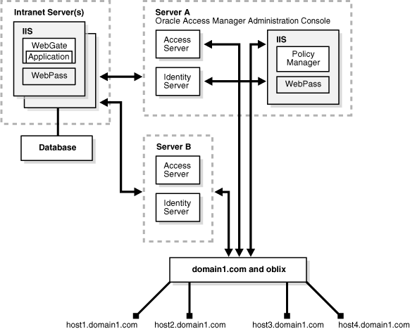

The following diagram Figure 1-1 illustrates hardware and software choices in an actual mid-sized (10,000-20,000 user) deployment. Using a poisson distribution, the estimated concurrency was predicted to be 74 users, with a 0.01% probability of having 100 or more users.:
For the production environment:
The servers are running Windows and Active Directory, IIS, and Oracle Access Manager.
Each server has two CPUs and 2 GB of RAM, and about 10 GB of disk space.
There are two Identity Servers running on different machines.
Multiple WebPass instances are installed in several intranet IIS servers, with at least one server acting as the administration console for the Identity System.
There are two Access Servers running on different machines.
There is one WebGate installed on each IIS intranet server.
The administrative console for the Access System is installed on an IIS server on one of the two Access and Identity Server boxes.
This environment could be scaled as follows:
The number of Oracle Access Manager Servers can be increased to spread the load and offer higher redundancy.
The number of CPUs, memory, and disk space can be increased to improve server performance.
The Active Directory environment supports the addition of new servers for cases where this is desired to improve performance and reliability.
