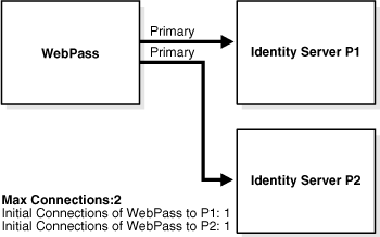

Configuring simple round-robin load balancing of Web component requests means that a Web component opens a single connection to each of its associated primary Oracle Access Manager Servers in the order they are listed, and distributes the requests evenly among them.
For example, assume that you have a single WebPass and two primary Identity Servers as shown in Figure 3-1. In this case, WebPass opens a connection to each Identity Server in the order they are listed. WebPass sends request1 to Identity Server P1, request2 to Identity Server P2, request 3 to Identity Server P1 and so on.
To configure simple round-robin load balancing
Access the Web component configuration whose requests you want to load balance.
For example:
From the Identity System Console, select System Configuration, WebPass.
From the Access System Console, select Access System Configuration, AccessGate Configuration.
See the Oracle Access Manager Identity and Common Administration Guide and Oracle Access Manager Access Administration Guide for more information about Web component configuration.
Enter the Maximum Connections you want opened for this WebPass or WebGate.
This is the total number of live connections you want established to one or more primary Identity or Access Servers at any given time. If the Web component cannot establish a connection to one of its primary servers, it tries to establish a connection to a secondary server.
Leave the Initial Connections to each associated Oracle Access Manager Server at the default, which is 1.
This applies to both primary and secondary Oracle Access Manager Servers.

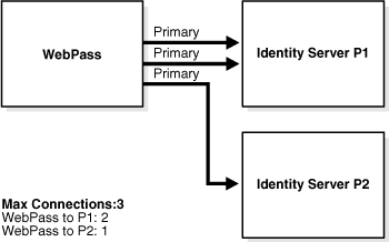

You may want to configure weighted round-robin load balancing of Web component requests if your Oracle Access Manager Servers have varying performance capacities. The primary difference when configuring weighted load balancing is that you adjust the initial connections you want established to each server.
Figure 3-2 provides an example. Assume you have two primary Identity Servers as shown in Figure 3-2. However, Identity Server P1 can handle additional load. Then you may want to configure WebPass to open two connections to Identity Server P1, and one connection to Identity Server P2. The Maximum Connections for that WebPass would be 3: Identity Server P1, request2 to Identity Server P2, request 3 to Identity Server P1 and so on.
Note: When you associate an AccessGate with an Access Server cluster, Oracle Access Manager automatically configures the number of connections between the AccessGate and all the Access Servers in the cluster based on the maximum number of connections that is specified for the cluster. Load balancing is dynamically configured and Oracle Access Manager ensures that the AccessGate routes requests to the most lightly loaded Access Servers in the cluster. |
To configure weighted round-robin load balancing of Web component requests
Access the Web component where you will configure load balancing.
For example:
From the Identity System Console, select System Admin, System Configuration, Configure WebPass.
Enter the Maximum Connections you want opened for a given WebPass.
Again, this is the total number of live connections you want established to one or more primary Identity Servers at any given time. If WebPass cannot establish a connection to one of its primary servers, it tries to establish a connection to another primary server.
Enter the Initial Connections to each associated Oracle Access Manager server to reflect that server's capacity.
Again, this applies to both primary and secondary servers. When you associate an AccessGate with an Access Server cluster, Oracle Access Manager automatically configures the number of connections between the AccessGate and all the Access Servers in the cluster based on the maximum number of connections specified for the cluster. Load balancing is dynamically configured and Oracle Access Manager ensures that the AccessGate routes requests to the most lightly loaded Access Servers in the cluster.

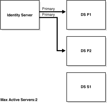

By default, Oracle Access Manager creates a directory profile for each installed component. When configuring load balancing for Oracle Access Manager requests to directory servers containing user data, you use the Directory Profile page. For more information on directory profiles, see the Oracle Access Manager Identity and Common Administration Guide.
Maximum Active Servers: The total number of live primary directory servers you want up and running at all times. Requests are distributed evenly across these servers.
As shown in Figure 3-3 assume you have 2 primary directory servers and one secondary directory server. You want to load balance between the primary directory servers, so you should enter Max Active Servers = 2. The secondary directory server only comes into play during failover and does not impact this setting.
To configure load balancing for user data
Access the Directory Profile page.
For example:
From the Identity System Console, select System Configuration, Directory Profiles.
From the Access System Console, select System Configuration, View Server Settings, Directory Options.
Under Configure LDAP Directory Server Profiles, select the name of the profile for the component and data where you want load balancing.
Enter the Maximum Active Servers available for load balancing.

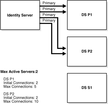

To adjust directory connection pooling from the directory profile
From the Directory Profile page, select a specific DB (directory) instance.
Enter the Initial Connections you want opened to this directory server.
The default is 1.
Enter the Maximum Connections allowed to this directory server instance.
If any of the connections to the directory server are lost, then Oracle Access Manager can attempt to open connections up to the maximum entered.
When the first request is sent to a directory server, the initial number of connections is opened. When connections are lost, or when there are more service threads than connections, new connections are opened (up to the maximum). See Figure 3-4 for an example.
For example, assume there are 5 initial connections and 10 max connections to a directory server. When a service thread makes a request to the directory server, then 5 initial connections are created. Assume now, that there are 5 concurrent active service threads that require information from the directory server. They will use all of the existing 5 connections.
If the concurrent service threads increase beyond 5 more connections, Oracle Access Manager can create up to 10 max connections to that directory server. When the limit of 10 connections is reached, and there are 11 or more concurrent service threads, the 11th service thread will get one of the least loaded connections from the pool of 10 connections. The connection is then shared by more than one service thread.
Note: There is no general optimal value for the initial and maximum connections, given variables such as directory configuration, hardware, and so on. However, you should not set the number of connections higher than the number of threads for a given Oracle Access Manager server. |

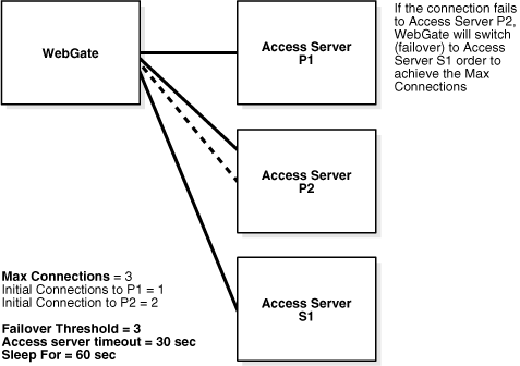

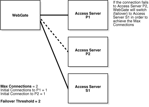

Oracle Access Manager uses failover to provide uninterrupted service. Failover involves re-directing requests to another server when the original request destination fails.
Failover is accomplished by configuring primary and secondary servers and identifying specific parameters for the failover process. Failover can be configured between:
Oracle Access Manager Web components to Oracle Access Manager Servers
WebPass requests to secondary Identity Servers
WebGate requests to secondary Access Servers
Oracle Access Manager Servers to directory servers
Identity Server to secondary directory servers
Access Server to secondary directory servers
Policy Manager to directory servers
Oracle Access Manager now provides the ability to perform failover from the Policy Manager to secondary directory servers.
Oracle Access Manager components first attempt to connect to a primary server.
If the primary server is unavailable, a connection attempt may be made to a secondary server. Oracle Access Manager continues to attempt to connect to the primary server, and when the connection is re-established, the connection to the secondary server is dropped. Any server can be configured as a primary or a secondary server. For example, you could designate less powerful or geographically distant servers as secondary.
A "heartbeat" polling mechanism facilitates immediate failover to a secondary directory server when the number of connections in the connection pool falls below the specified threshold level. Additionally, a failback mechanism facilitates switches from the secondary directory server back to the primary server as soon as the preferred connection has been recovered.
The heartbeat feature polls all the primary directory server connections periodically to verify the availability of the directory service (and by implication, the network). You configure the polling interval by setting the Sleep For (Seconds) parameter for each directory profile.
When the host cannot be reached, further attempts to connect to that host are blocked for the specified Sleep For interval, rather than for the TCP timeout used previously.
A heartbeat_ldap_connection_timeout_in_millis parameter in globalparams.xml determines the timeout interval for establishing a connection. If the directory service is not available, the heartbeat mechanism immediately initiates failover to the secondary directory server. This enables failover without requiring an incoming directory service request and a subsequent TCP timeout.
The heartbeat_enabled parameter indicates whether the Identity and Access Servers should proactively identify when a directory server is down. Oracle recommends that you enable this function.
Note: If your network is slow and the heartbeat_ldap_ connection_ timeout_in_millis is set to a low value (for example, 10 milliseconds), the heartbeat mechanism can give an incorrect indication that directory is unreachable when it is up and working. |

In Figure 3-6 a WebGate communicates with two primary Access Servers (Access Server P1 and Access Server P2).
The Maximum Connections is 3. Assume that Access Server P2 can handle additional load, and therefore two initial connections are established to it.
The Failover Threshold is 3. If the number of valid connections drops below the failover threshold, WebGate tries to establish a connection to its secondary server, Access Server S1. Assume that Access Server P2 dropped its second connection.
The Access Server Timeout Threshold parameter is set for 30 seconds. If the WebGate does not receive a response from the Access Server P2 in 30 seconds, it considers the server unreachable and attempts to failover to Access Server S2.
The Sleep For parameter is set for 60 seconds. Every 60 seconds this WebGate checks whether the number of valid connections to primary servers equals the specified number of maximum connections. If not, WebGate continues its attempts to re-establish connections to failed primary Access Server P2.
