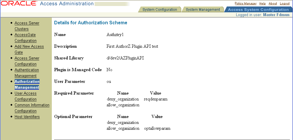

To use a plug-in created by the Authorization Plug-in API, two types of information need to be configured by an administrator.
An authorization scheme to use the plug-in. A given scheme can use both authorization plug-ins and custom action plug-ins.
A custom authorization rule to use the scheme.

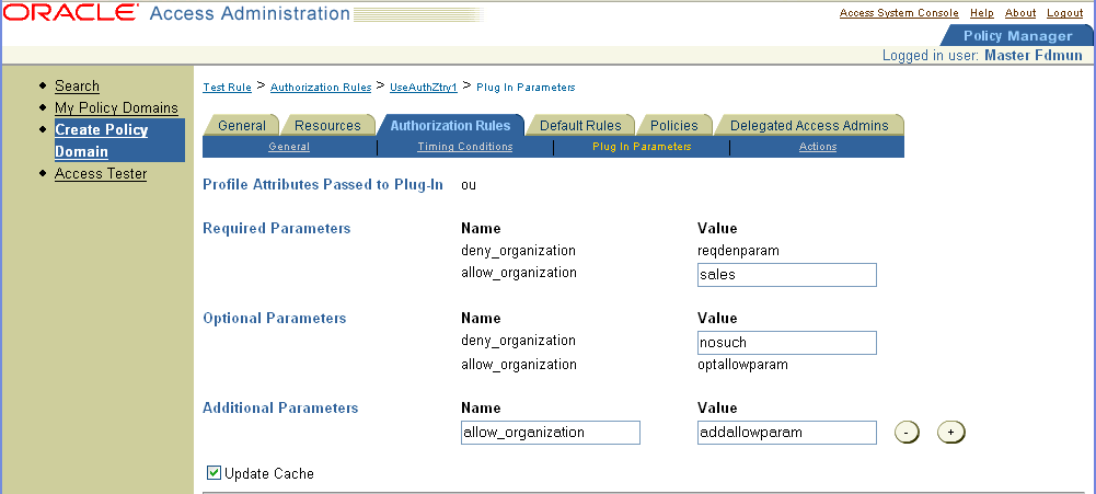

Params |
Names and values for all required, optional, and additional parameters specified in the plug-in configuration. The plug-in cannot change this data. Names are created when an Authorization scheme is first created by the System or Master Access Administrator. Values can be provided when the scheme is first created, or added later by a Delegated Access Administrator when the scheme is used in an Authorization Rule. |

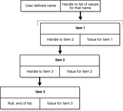

Understanding the organization of the ObAzPluginInfo structure is key to understanding how the Authorization Plug-in API works.
In the Authorization Plug-in API, all structure members are multivalued, meaning that the names held within each structure may each have more than one value. Each name has an associated handle that points to a list of one or more items. Each item contains a value and a handle to the next item in the list. A handle for the next item set to NULL indicates the end of the list.
The params member can be thought of according to the following diagram. You use GetDataFn to get the pointer to the list, for a specified parameter name within the params array.You then use GetFirstItemFn to get a handle to the information for the first item in the list. GetValueFn at this point returns the value for item 1, GetNextFn returns the handle to the information for item 2, and so on.

Functions used by the API to talk to the Access Server are of two types. They can be provided by the Access Server, in which case they are called by reference to it. Otherwise, they must be implemented in the plug-in, following the prototypes in authz_plugin_api.h.
These functions get and set data in the structures that have been passed. To use these functions you must call them as members of the structure of type ObAzPluginFns that you named in your code. For example, if you implemented ObAzPluginFn and set the variable name of type ObAzPluginFns to pFnBlock, then you call GetDataFn by reference to its place in the structure, as pFnBlock->GetDataFn.
The plug-in uses this function to get a handle to the head of a list of values associated with a name in one of the members of the ObAzPluginInfo structure. The plug-in must then use the list manipulation functions GetFirstItemFn, GetValueFn, GetNextFn, GetValueFn, and so on, to extract information from the list. The function takes the form:

The following screen shows the initial setup for the Authorization Scheme, as set by the Access Administrator. Note that space has been left for a required parameter, but no value has been entered.
Later, when a policy is defined to cover a resource that uses this Authorization scheme, the Delegated Access Administrator provides the missing required parameter value. In the following example, an additional value is also added.
Given this version of the authorization scheme, the corresponding trace information given by the sample code is:
initializing
deallocating
doing real work
first test okay, getting ou
ou was not null
ou is Sales
deny1 is nosuch
deny2 is reqdenparam
allow1 is sales
allow2 is addallowparam
allow3 is optallowparam
access was allowed

GetParams |
Returns names and values for all required, optional, and additional parameters specified in the plug-in configuration. The plug-in cannot change this data. Names are created when an authorization scheme is first created by the System or Master Access Administrator. Values can be provided when the scheme is first created, or added later by a Delegated Access Administrator when the scheme is used in an authorization rule. |

In the authorization plug-in API, all structure members are multi-valued, meaning that the names help within each structure may each have more than one value. Each name has an associated list of one or more items. Each item contains a value.
This interface provides the functions to get the list of items.
public _gc _interface IObAzPluginData
_property IEnumerator* get_Data(String* pName);
The plug-in uses this function to get a list of values associated with a name in one of the members of the ObAzPluginInfo structure. The plug-in must then use the enumeration functions Current, MoveNext, and Reset to obtain items from the list.
| Name | Purpose |
pName |
The name for which values are to be retrieved. |
The function returns an object which implements the interface IEnumerator.

Plug-ins allow optional parameters, that would usually be filled in by a Delegated Administrator when schemes are created. Plug-ins should be able to gracefully handle the situation in which values for these parameters are not supplied.
