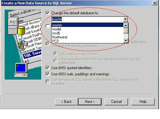

  7. Change the DSN (ODBC Data Source Name used by the RDBMS profile of audit & reporting applications) on this machine to refer to the new database instance. For example:
    Note:
    If you have multiple Identity Servers on the same machine, be sure to upgrade all Identity Server instances on this machine before you change the DSN to refer to the new database. In this case, skip to step 9.
    Figure 12-1 Create a New Data Source to SQL Server Window
    Description of "Figure 12-1 Create a New Data Source to SQL Server Window"

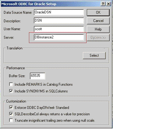

  6. Change the DSN (ODBC Data Source Name used by the RDBMS profile of audit & reporting applications) on this machine to refer to the new database instance. See your vendor documentation for details about performing this task. For example:
    Note:
    If you have multiple Identity Servers on the same machine, be sure to upgrade all Identity Server instances on this machine before you change the DSN to refer to the new database. In this case, skip to step 7.
    Figure 12-2 Microsoft ODBC for Oracle Window
    Description of "Figure 12-2 Microsoft ODBC for Oracle Window"
