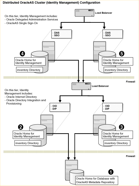

Distributed OracleAS Cluster (Identity Management). See Section 9.6.

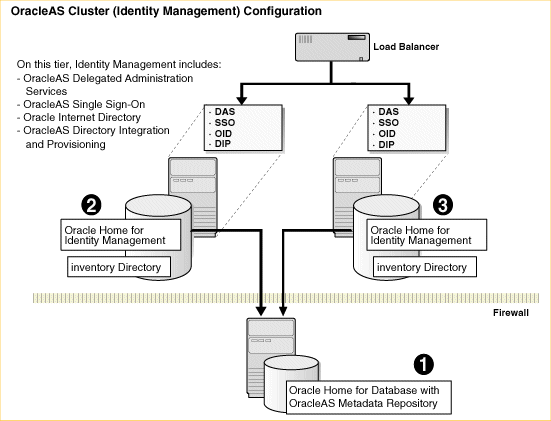

In this configuration, you need an existing database that is already running in a configuration supported by the OracleAS RepCA. Oracle recommends running the database in a high availability environment, such as a Real Application Clusters database. You also need additional nodes (at least two nodes) to run Oracle Identity Management components. In this configuration, Oracle Internet Directory, OracleAS Single Sign-On, and Oracle Delegated Administration Services run on each node. If you want to distribute these components, see Section 9.6, "Installing a Distributed OracleAS Cluster (Identity Management) Configuration".
These nodes are accessed through a load balancer. See Figure 9-1.

Figure 9-1 OracleAS Cluster (Identity Management) Configuration

Key Points for Installing on the First Node
In the Select Configuration Options screen, select High Availability and Replication, in addition to selecting the components.
In the Select High Availability or Replication Option screen, select OracleAS Cluster (Identity Management).
Table 9-4 Steps for Installing OracleAS Cluster (Identity Management) on the First Node

Figure 9-2 Distributed OracleAS Cluster (Identity Management) Configuration
Subsections:
Section 9.6.3, "Installing Oracle Internet Directory on the First Node"
Section 9.6.4, "Installing Oracle Internet Directory on Subsequent Nodes"
To create a distributed OracleAS Cluster (Identity Management) configuration:
Install OracleAS Metadata Repository in your existing database.
Install Oracle Internet Directory on each node. You run the installer on each node separately.
Note: If you want to configure Oracle Internet Directory to listen on SSL ports only, perform this configuration after you have installed OracleAS Single Sign-On and Oracle Delegated Administration Services. Oracle Internet Directory needs to be listening on both SSL and non-SSL ports when you install OracleAS Single Sign-On and Oracle Delegated Administration Services. |
Install OracleAS Single Sign-On and Oracle Delegated Administration Services on each node. You run the installer on each node separately.
Install middle tiers.

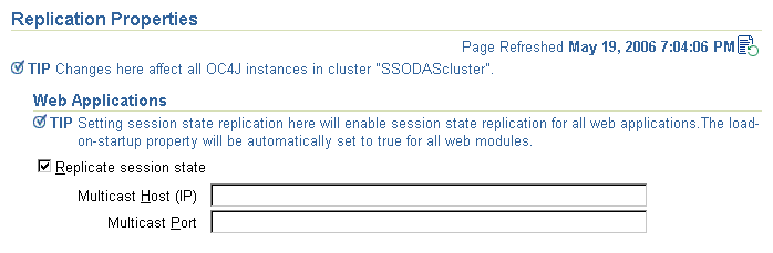

To ensure that Oracle Application Server maintains the state of stateful Web applications across DCM-Managed OracleAS Cluster, you need to configure state replication for the Web applications. Configure state replication only on the first node where Oracle Delegated Administration Services is installed.
To configure state replication for the OC4J_Security instance, do the following:
Using the Application Server Control Console, navigate to the Application Server Home page for the instance that contains Oracle Delegated Administration Services.
Select the OC4J_SECURITY link on the Application Server Home page.
Select the Administration link on the OC4J Home Page.
Select the Replication Properties link in the Instance Properties area.
Scroll down to the Web Applications section. Figure 9-3 shows this section.
Figure 9-3 Web State Replication Configuration
Select the Replicate session state checkbox.
Optionally, you can provide the multicast host IP address and port number. If you do not provide the host and port for the multicast address, it defaults to host IP address 230.230.0.1 and port number 9127. The host IP address must be between 224.0.0.2 through 239.255.255.255. Do not use the same multicast address for both HTTP and EJB multicast addresses.
Note: When choosing a multicast address, ensure that the address does not collide with the addresses listed in:
Also, if the low order 23 bits of an address is the same as the local network control block, 224.0.0.0 – 224.0.0.255, then a collision may occur. To avoid this problem, provide an address that does not have the same bits in the lower 23 bits of the address as the addresses in this range. |
