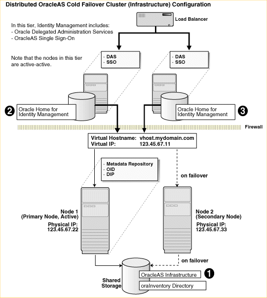

Distributed OracleAS Cold Failover Cluster (Infrastructure). See Section 8.4.

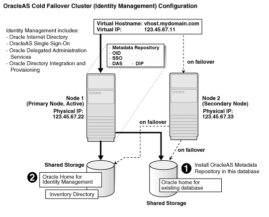

OracleAS Cold Failover Cluster (Identity Management). See Section 8.5.

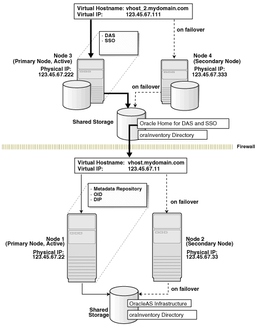

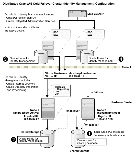

Distributed OracleAS Cold Failover Cluster (Identity Management). See Section 8.6.

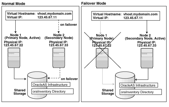

The figure shows:
two nodes running clusterware
storage devices local to each node
storage device that can be accessed by both nodes. You install OracleAS Infrastructure on this shared storage device.
During normal operation, one node ("node 1") acts as the active node. It mounts the shared storage to access the OracleAS Infrastructure files, runs OracleAS Infrastructure processes, and handles all requests.
If the active node goes down for any reason, the clusterware fails over OracleAS Infrastructure processes to the other node ("node 2"), which now becomes the active node. It mounts the shared storage, runs the processes, and handles all requests.
These nodes appear as one computer to clients through the use of a virtual address. To access the OracleAS Infrastructure, clients, including middle-tier components and applications, use the virtual address associated with the cluster. The virtual address is associated with the active node (node 1 during normal operation, node 2 if node 1 goes down). Clients do not need to know which node (node 1 or node 2) is servicing requests.

Figure 8-2 shows a distributed OracleAS Cold Failover Cluster (Infrastructure) configuration.
This configuration is similar to the configuration described in Section 8.3, "Installing an OracleAS Cold Failover Cluster (Infrastructure) Configuration", except that the OracleAS Single Sign-On and Oracle Delegated Administration Services components are installed separately on other nodes in an active-active configuration.
Figure 8-2 Distributed OracleAS Cold Failover Cluster (Infrastructure) Configuration
In a distributed OracleAS Cold Failover Cluster (Infrastructure) configuration, you run the OracleAS Metadata Repository, Oracle Internet Directory, and Oracle Directory Integration Platform in an active-passive configuration.
However, the OracleAS Single Sign-On and Oracle Delegated Administration Services components run in an active-active configuration. You have a load balancer to direct requests to the nodes running these components.
To set up a distributed OracleAS Cold Failover Cluster (Infrastructure) configuration, perform these steps:

Figure 8-3 shows an OracleAS Cold Failover Cluster (Identity Management) configuration.
This configuration is suitable if you have the OracleAS Metadata Repository database in a separate highly available environment and you want to use an active-passive configuration for the Oracle Identity Management components. You install the Oracle Identity Management components on a shared disk different from the share disk that contains the OracleAS Metadata Repository database.
This configuration includes:
two clustered nodes
two shared disks that can be accessed by both nodes. One shared disk contains the Oracle home for the database (on which you will load the OracleAS Metadata Repository), and on the other shared disk, you will install Oracle Identity Management.
During normal operation, node 1, which is the primary node, is the active node. It mounts both shared disks to access the Oracle Identity Management and database files, runs the Oracle Identity Management and database processes, and handles all requests.
If node 1 goes down for any reason, the clusterware fails over the Oracle Identity Management and database processes to node 2. Node 2 becomes the active node, mounts both shared disks, runs the processes, and handles all requests.
To access the active node in an OracleAS Cold Failover Cluster, clients, including middle-tier components and applications, use the virtual hostname associated with the OracleAS Cold Failover Cluster. The virtual hostname is associated with the active node (node 1 during normal operation, node 2 if node 1 goes down). Clients do not need to know which node (primary or secondary) is servicing requests.
You also use the virtual hostname in URLs that access the infrastructure. For example, if vhost.mydomain.com is the name of the virtual host, the URLs for the Oracle HTTP Server and the Application Server Control would look like the following:

Figure 8-3 OracleAS Cold Failover Cluster (Identity Management) Configuration
To create an OracleAS Cold Failover Cluster (Identity Management) configuration against an existing cold failover cluster database, perform these steps:

Figure 8-4 shows a distributed OracleAS Cold Failover Cluster (Identity Management) configuration.
It consists of:
two nodes running Oracle Delegated Administration Services and OracleAS Single Sign-On. These nodes are accessed through a load balancer.
two nodes running in an active-passive configuration. These nodes will run the existing cold failover cluster database, Oracle Internet Directory, and Oracle Directory Integration Platform.
two shared disks. One shared disk contains the database Oracle home. On the other shared disk, you will install Oracle Internet Directory and Oracle Directory Integration Platform.
firewalls to separate the tiers
Tier Running the Oracle Internet Directory, Oracle Directory Integration Platform, and Database
In this tier, during normal operation, the active node mounts the shared disks to access the Oracle Identity Management and database; runs the Oracle Internet Directory, Oracle Directory Integration Platform, and database processes; and handles all requests.
If the active node goes down for any reason, the clusterware fails over the processes to the secondary node (node 2), which becomes the new active node, mounts the shared disks, runs the processes, and handles all requests.
To access the active node, clients, including middle-tier components and applications, use the virtual hostname. The virtual hostname is associated with the active node (which is the primary node during normal operation, the secondary node upon failover). Clients do not need to know which node (primary or secondary) is servicing requests.
You need to use the virtual hostname in URLs to access the active node. For example, if vhost.mydomain.com is the virtual hostname, the URLs for the Oracle HTTP Server and the Application Server Control for this tier would look like the following:

Tier Running Oracle Delegated Administration Services and OracleAS Single Sign-On
Note that the nodes in this tier are not clustered. Both nodes are active at the same time, and you install the files locally on each node. To access these nodes, clients go through a load balancer. For example, if the name of the load balancer is loadbalance1.mydomain.com, the URLs for the Oracle HTTP Server and the Application Server Control for this tier would look like the following:

Figure 8-4 Distributed OracleAS Cold Failover Cluster (Identity Management) Configuration
To create a distributed OracleAS Cold Failover Cluster (Identity Management) configuration against an existing cold failover cluster database, perform these steps:

The configuration described in this section is similar to that described in Section 8.4, "Installing a Distributed OracleAS Cold Failover Cluster (Infrastructure) Configuration". The difference is that in the configuration described in this section, OracleAS Single Sign-On and Oracle Delegated Administration Services run in an OracleAS Cold Failover Cluster configuration.
You need two sets of clustered nodes. See Figure 8-5. One set runs the OracleAS Metadata Repository and Oracle Internet Directory, and another set runs Oracle Delegated Administration Services and OracleAS Single Sign-On.
For each set, you need a shared storage and a virtual hostname. You install Oracle homes for the various Oracle Application Server components on the shared storage.
Figure 8-5 Oracle Delegated Administration Services and OracleAS Single Sign-On in a Cold Failover Cluster

Step 2 (optional) Create staticports.ini Files
If you wish, you may set up two staticports.ini files, one for each set of nodes. For information on staticports.ini, see Section 2.6.3, "Using Custom Port Numbers (the "Static Ports" Feature)".
Step 3 Install OracleAS Metadata Repository and Oracle Internet Directory
Install OracleAS Metadata Repository and Oracle Internet Directory in the same Oracle home by selecting Identity Management and OracleAS Metadata Repository in the Select Installation Type screen. This option creates a new database for the OracleAS Metadata Repository and a new Oracle Internet Directory.
The steps are the same as those listed in step 2, "Install OracleAS Infrastructure", with these differences:
In the Select Configuration Options screen, select these components/options:
High Availability and Replication
Do not select these components:
Oracle Application Server Single Sign-On
Oracle Application Server Delegated Administration Services
Oracle Application Server Certificate Authority (OCA)
In the Specify Port Configuration Options screen, select Manual and enter the fullpath to the staticports.ini file that you created in the previous step.
Step 4 Install Oracle Delegated Administration Services and OracleAS Single Sign-On from Node 3
From node 3, install Oracle Delegated Administration Services and OracleAS Single Sign-On on the shared disk by following the steps in Table 8-9.
Key Points
When the installer prompts you for the Oracle home path, enter a path on the shared disk. Make sure that both nodes can access this path.
In the Select High Availability or Replication Option screen, select Virtual Host.
In the Specify Virtual Hostname screen, enter the virtual hostname.
Table 8-9 Installing Oracle Delegated Administration Services and OracleAS Single Sign-On
