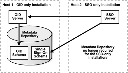

In addition, your OracleAS Identity Management configuration can be distributed or non-distributed. Consider the following examples of distributed OracleAS Identity Management installations:
Figure 7-1 shows how the OracleAS Single Sign-On component of OracleAS Identity Management can be installed in a separate 10g (9.0.4) Oracle home from the Oracle Internet Directory, but share the same OracleAS Metadata Repository.

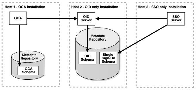

Figure 7-2 shows an extension of the previous example. It introduces a third host, which is used to host an Oracle Application Server Certificate Authority (OCA) installation. The OCA installation uses the same Oracle Internet Directory as OracleAS Single Sign-On, but it has its own OracleAS Metadata Repository to store the OCA schema.
Figure 7-1 Distributed Identity Management - Example 1
Figure 7-2 Distributed Identity Management - Example 2

The following sections describe how to upgrade a distributed OracleAS Identity Management configuration:
Upgrading a Distributed OracleAS Identity Management Configuration
Verifying Whether OracleAS Identity Management Components are Enabled or Disabled
A distributed OracleAS Identity Management configuration consists of multiple Oracle homes. One of the Oracle homes contains the Oracle Internet Directory.
In a distributed OracleAS Identity Management installation, the other Oracle homes contain additional OracleAS Identity Management components, such as OracleAS Single Sign-On, Delegated Administration Services, Oracle Directory Integration and Provisioning, and OracleAS Certificate Authority.
To upgrade a distributed OracleAS Identity Management configuration (as shown in Figure 7-1), do the following:
Review Section 7.5.3.2, "Verifying Whether OracleAS Identity Management Components are Enabled or Disabled" to determine exactly which OracleAS Identity Management components will be upgraded.

When you upgrade a distributed OracleAS Identity Management configuration, the 10g (10.1.4.0.1) installer will upgrade any OracleAS Identity Management components that are enabled in the source Oracle home.
An OracleAS Identity Management component is considered enabled when it is marked as such in the following configuration file in the source Oracle home:
SOURCE_ORACLE_HOME\config\ias.properties
Before you upgrade your Oracle Internet Directory installation in a distributed OracleAS Identity Management configuration, you can check the contents of this file to verify which components are enabled. If necessary, modify the entries to reflect exactly which components you have enabled, and as a result, which components will be upgraded.
If you are running only Oracle Internet Directory in the Oracle home, the ias.properties file should contain the following entries:
SSO.LaunchSuccess=False OID.LaunchSuccess=True DAS.LaunchSuccess=False DIP.LaunchSuccess=False OCA.LaunchSuccess=False
On the other hand, if you are running OracleAS Single Sign-On, Oracle Delegated Administration Services, and Oracle Directory Integration and Provisioning in one Oracle home, but using Oracle Internet Directory in another Oracle home, the entries would appear as follows:
SSO.LaunchSuccess=True OID.LaunchSuccess=False DAS.LaunchSuccess=True DIP.LaunchSuccess=True OCA.LaunchSuccess=False
