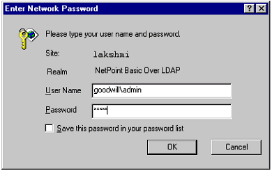

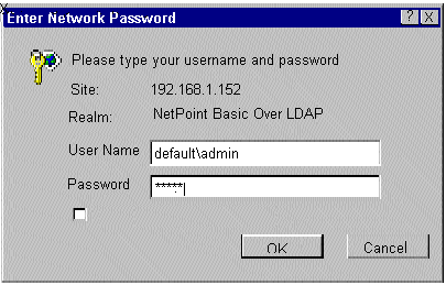

Following is resulting basic login window related to the single sign-on.
If you are configuring for an Active Directory forest, the domain the user belongs to is determined by the directory profiles configured in the Identity System and used by the Access System. These directory profiles can be enabled or disabled through the Configure Directory Server Profile page accessible from the Identity System Console, Configure Directory Options function.
If a directory profile is disabled and the user enters that domain name during login through the Access System, then the user is not allowed access.
If a directory profile is enabled and user enters that name as the domain name, then the user is allowed access.
