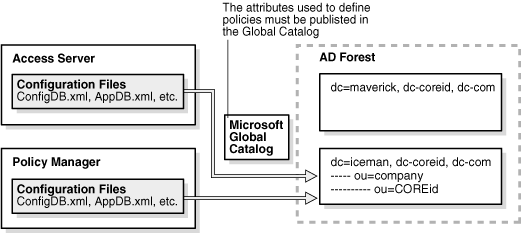

The steps in this section are based on the following example. In this case, the Identity System was configured using the two domains shown in Figure C-1. For example:
dc=maverick,dc=oblix,dc=com
dc=iceman,dc=oblix,dc=com

Suppose the Identity System was set up as shown earlier with the configuration data in the dc=iceman,dc=oblix,dc=com domain.
In this case, the Policy Manager must also be set up for this domain. To accomplish this, you must specify the same configuration DN for the Policy Manager and the Identity Server.

Set up the Policy Manager with the same configuration DN as the Identity Server.
For example, against the machine containing the domain: dc=iceman,dc=oblix,dc=com
Before starting the Web server, change the port to 3268 (open LDAP) to ensure that users and groups are accessible from both domains.
