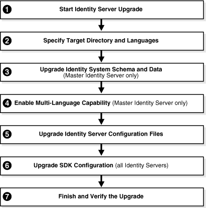

Figure 6-1 illustrates the tasks you must perform to complete the Identity System schema and data upgrade. Additional notes follow the figure. You will see references to the Identity Server (formerly known as the NetPoint or COREid Server). Refer to your own planning worksheets and use the checklists in Appendix E, "Planning Worksheets and Tracking Checklists" to track your progress.
Figure 6-1 Identity System Schema and Date Upgrade Task
Task overview: Upgrading the Identity System schema and data
Complete all prerequisite tasks outlined in "Master Identity System Schema and Data Upgrade Prerequisites".
Upgrade the newly added master Identity Server and accept the automatic schema and data upgrade as explained in .
Upgrade the master WebPass you added, as discussed in "Upgrading the Master WebPass"
Confirm the upgrade was successful, as described in "Verifying the Identity System Schema and Data Upgrade".
Upgrade Successful: Perform remaining activities in the following sequence:
Upgrade Not Successful: Proceed to "Recovering From an Identity System Schema or Data Upgrade Failure".
Checklists that can help you track the completion of upgrade tasks in your environment are provided in Appendix E, "Planning Worksheets and Tracking Checklists".

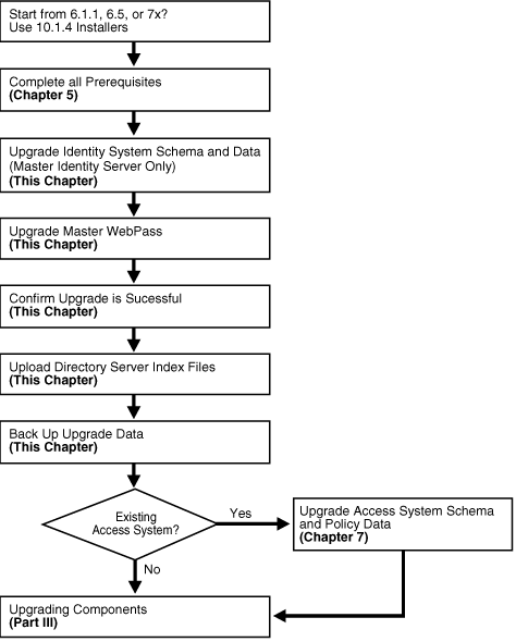

Figure 6-2 illustrates the program-driven process and decision points where you are asked to provide specific responses to continue. Each box in the diagram points to a similarly named discussion that guides you through the procedure. You must complete all procedures for a successful upgrade.
Figure 6-2 Identity System Schema and Data Upgrade Process
Task overview: Upgrading the schema and data with the master Identity Server includes
Starting the Master Identity Server Upgrade describes how to launch the upgrade using your preferred method (GUI or Console).
Specifying the Target Directory and Languages describes how you indicate the directory where the existing component is installed as well as any languages to upgrade.
Updating the Identity System Schema and Data describes how to accept the automatic schema and data upgrade.
Oracle recommends that you accept the automatic schema and data upgrade for the master Identity Server.
Note: With ADAM you must manually upgrade the schema; however, the data upgrade is automatic. For more information, see "Active Directory Application Mode Considerations and Preparation". |
Later, when upgrading remaining COREid Servers, the upgraded schema and data are detected automatically; related messages and events are suppressed.
Enabling Multi-Language Capability describes the automated process that occurs only when you upgrade a release 6.1.1 master COREid Server.
Note: Enabling multi-language capability is automatically skipped if your starting release is 6.5 or 7.x. |
Upgrading Identity Server Configuration Files describes how to apply changes to the component-specific configuration files.
Upgrading the Software Developer Kit (SDK) Configuration shows how to accept or decline the SDK configuration changes.
Note: If this master COREid Server does not have caching configured, you may decline the automatic SDK configuration upgrade. |
Finishing and Verifying the Master COREid Server Upgrade describes critical actions that you need to take to determine the success of the upgrade.

Updating component-specific configuration files.
Review messages for the upgrade from release 7.x to 10g (10.1.4.0.1). For example:

Proceed with "Upgrading the Software Developer Kit (SDK) Configuration" next.

Go to "Finishing and Verifying the Master COREid Server Upgrade".
You complete this procedure to finish the upgrade of the master COREid Server and the Identity System schema and data.

After upgrading the master Identity Server, you must upgrade the master WebPass instance. There is no WebPass connection to a directory server. Therefore, there is no schema or data upgrade during a WebPass upgrade.
When upgrading WebPass (and other Oracle Access Manager Web components), the component-specific upgrade includes both Web component and Web server configuration file updates. There are no differences between upgrading the master WebPass now and upgrading subsequent WebPass instances later on.
Figure 6-3 illustrates the program-driven WebPass upgrade process and the points at which you need to provide specific input or acknowledge events. Additional comments follow the figure.
Figure 6-3 Master WebPass Upgrade Process
Task overview: Upgrading master WebPass includes
Starting the Master WebPass Upgrade, Specifying a Target Directory and Languages is described
Upgrading WebPass Configuration Files and Web Server Configurationis described
Finishing and Verifying the Master WebPass Upgrade is described

You complete this task to confirm that the Identity System upgrade has been successful.
To verify the schema and data upgrade
Check to ensure that the schema contains 10g (10.1.4.0.1) attributes obPolicyEnabled and objectclass oblixLPMPolicy.
View the configuration node in the configuration directory server and confirm that the value of the obver attribute is 10.1.4.0.1.
Upgrade Successful: Perform the tasks in the following list, as described in:

After you finish the schema and data upgrade, Oracle recommends that you back up the 10g (10.1.4.0.1) component directory and directory server instances. This will enable you to easily restore your environment to the newly upgraded state should that be a requirement.
To back up critical information after the upgrade
Back up the 10g (10.1.4.0.1) Identity Server directory and store it in a new location.
Back up upgraded directory server instances using your directory vendor documentation as a guide.
Back up Identity System data as described in"Backing Up Existing Oracle Access Manager Data" .
Windows: Back up the upgraded registry for the component as described in "Backing Up Windows Registry Data".
WebPass Web Server: Back up the upgraded Web server configuration file using your vendor documentation as a guide.
Proceed to "Looking Ahead".
