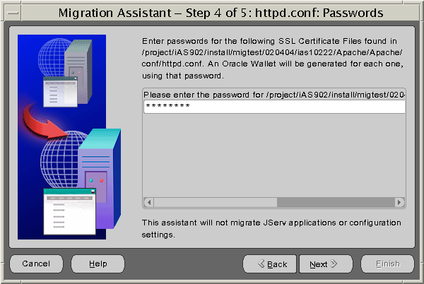

Before you start the Assistant, be prepared with the password for the SSL certificate key file for the Oracle HTTP Server, if a password other than the default 'welcome' password was assigned. See Table 2-4 for password requirements. This password is used to generate the wallet during SSL conversion. If you enter the password incorrectly 3 times, components containing the SSL-related information are set to non-migratable status (excluded from the migration).

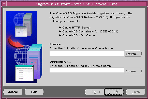

The Oracle Home screen appears (Figure 5-1).
ORACLE_HOME_1
. You can:
ORACLE_HOME_2
. You can:

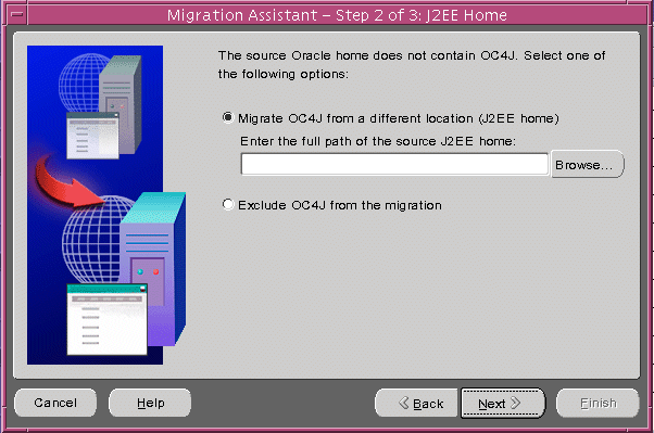

If OC4J was not found in the Source... path you specified, the J2EE Home screen appears (Figure 5-2).

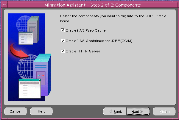

The Components screen appears (Figure 5-3). By default, all of the components are selected for migration.

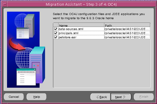

If OC4J was selected, the OC4J screen appears (Figure 5-4). By default, all applications are selected for migration. See "OC4J Migration Candidates" for information on how the configuration files and applications are identified for migration.
If any migrated application uses datasource tags, you must select data-sources.xml for migration. If you do not, the migration will fail.

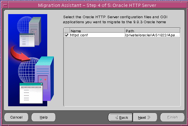

If Oracle HTTP Server was selected, the Oracle HTTP Server screen appears (Figure 5-5). By default, all of the configuration files, CGI applications, and static documents found are selected for migration. See "Oracle HTTP Server Migration Candidates" for information on how the configuration files and applications are identified for migration.
If an SSL certificate file was found with a password other than the default 'welcome', the httpd.conf: Passwords screen appears (Figure 5-6).

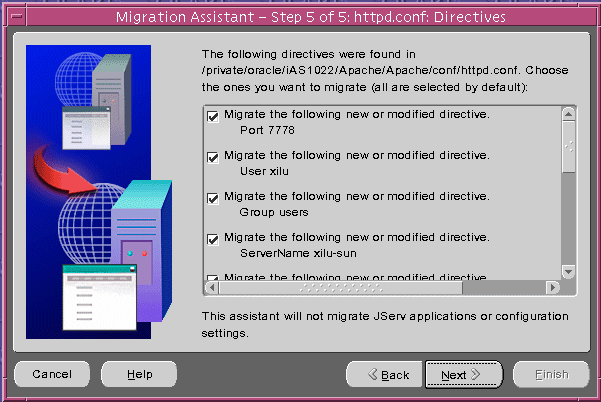

The httpd.conf: Directives screen appears (Figure 5-7), which is populated with the directives you can choose to migrate. By default, all directives except for mod_proxy are selected for migration. See "The Oracle HTTP Server Directive Migration Process" for information on how the Assistant compiled this list of directives.

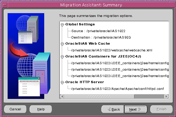

The Summary screen appears (Figure 5-8), showing your choices of Oracle homes, configuration files, and applications.

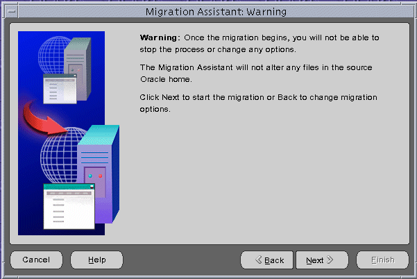

The Warning screen appears (Figure 5-9).
Warning: If you click Next now, the Assistant will begin to apply the current migration selections. Once the migration begins, you can click Cancel to stop the Assistant. It will finish the migration in progress (Oracle HTTP Server, OC4J or Web Cache), and then stop. No other selected migrations will start. To undo a migration, you must manually restore the configuration files in the 9.0.3 instance from a backup. For a description of backups and file names, see:

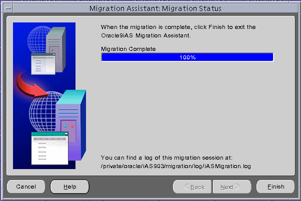

The Migration Status screen appears with a progress bar showing the percentage of the migration completed (Figure 5-10).
