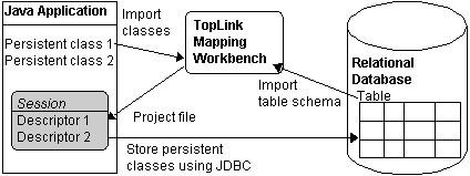

The Mapping Workbench is separate from Oracle9iAS TopLink - it allows you to graphically configure descriptors and map your project. The Mapping Workbench can verify the descriptor options, access the data source, and create the database schema. With the Mapping Workbench you can define TopLink descriptors without using code.

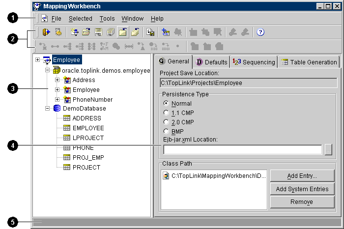

The Mapping Workbench interface includes these parts:
User-interface components called out in Figure 1-2:
The TopLink Mapping Workbench contains two types of menus:
The menu bar provides pull-down menus for each TopLink Mapping Workbench function. Some menus (such as Selected) are context-sensitive - the available options may vary, depending on the currently selected object.

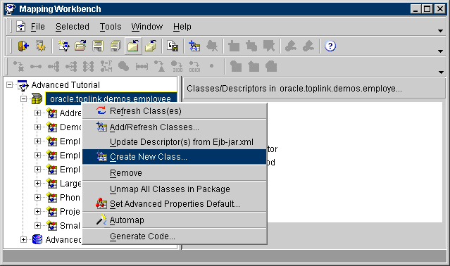

When you right-click on objects in the Project Tree pane, a pop-up menu appears with functions specific to the selected object.

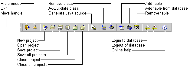

The Mapping Workbench contains two types of toolbars:
Use these toolbars to select options and functions.
The standard toolbar provides quick access to the standard (File, Edit, Selected, etc.) menu options.

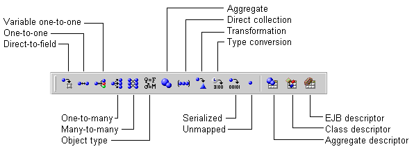

The mapping toolbar provides quick access to create mapping and descriptor types. You can specify a mapping or descriptor type by selecting the object from the Project Tree pane then clicking on the appropriate button in the mapping toolbar.
You can also right-click on the object and select the appropriate mapping from the pop-up menu.
To move a toolbar, click on a blank area of the toolbar and drag it to your desktop. To re-dock the toolbar to the Mapping Workbench, click on the toolbars's move handle
and drag the toolbar back to the Mapping Workbench.

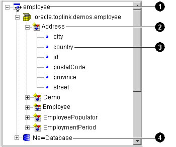

TopLink displays each project's descriptors, mappings, and database tables in the Project Tree pane on the left side of the workbench.
User-interface components called out in Figure 1-6:
Click on the +/- next to the item, or double-click the item name, to expand/collapse the item.
When you select an item in the Project Tree pane, its properties appear in the Properties pane (see "Using the Properties Pane").
You can perform specific functions for an item by selecting the item in the Project Tree pane and:
Inactive descriptors appear dimmed in the Project Tree pane. Inactive descriptors do not get registered with the session when the project is loaded into Java. This allows you to define and test subsets of descriptors. To activate or inactivate a descriptor, right-click on the descriptor and select Activate/Deactivate Descriptor from the pop-up menu.

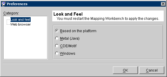

Use this procedure to customize the "look and feel" (the graphical user interface) of the Mapping Workbench.
in the toolbar. The Preferences window appears.
You can also display the preferences window by selecting Tools > Preferences from the menu.
User-interface "look and feel" samples in Figure 1-9:

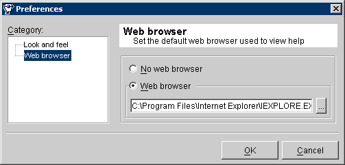

Use this procedure to specify a web browser to use with the Mapping Workbench. You must specify a web browser to use the online help and web-based support.

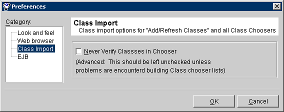

Use this option to specify if the Mapping Workbench verifies classes on import, when using the Add/Refresh Class function (see "To Update Classes from Available Packages and Classes:").

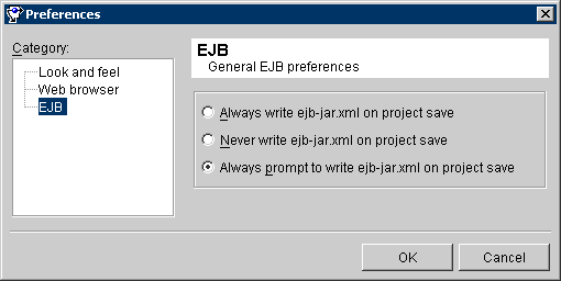

Use this procedure to specify how the Mapping Workbench updates the ejb-jar.xml file when saving projects.
ejb-jar.xml file when you save the project.
